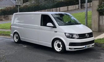

I had 16" alloys on with standard suspension. I've just had Bilstein So Low kit fitted on their highest setting with 17" banded steels. According to the guys at Transporter HQ, this should be a drop of around 80mm. The max (lowest) out the box is 100mm front, 130mm rear.
But I've measured the front and I'm getting 34cm from centre of hub to top of wheel. This would make a drop of about 120mm! and its on the highest setting.
Don't get me wrong, it looks amazing and the suspension works really well and for the most part I love it. However there's one thing that is bugging me. Every time I put it in reverse the front parking sensors are going nuts! So I'd like to raise it ever so slightly. So I'm trying to work out if I've had them fitted a little wrong. So I need to check measurements first.
