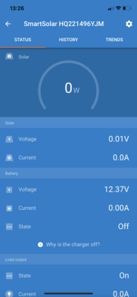

Doesn’t look like the PV is working. It’s full sun and showing nothing on the App . Not sure if it’s the panel , set up in App or whatever.
Post a screen shot of the app showing the solar charger.

Have you checked with your multimeter for a voltage across the PV wires (now you've got them the right way round?!) This is bringing back horrible memories of my own panel dying 12 months ago. I was getting 0.01 volts off my bad panel. My new replaced panel has started to de-laminate but that's another tale of panel woe.
Reactions: MrD
Checked the positive and negative for panel on and off just now …… nothing.
Checked the actual panel junction box on top but it’s full of sealant so a no go.
Checked the join on the panel cables to the van cables (poor yellow compression sleeve joins) it seems sound no breaks .
Looks like a dead panel then .
