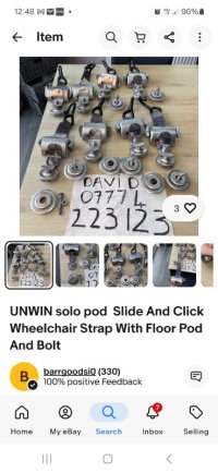

My son.is a full time wheelchair user. We have a LWB T30 that I'm hoping we can get him away for one possibly two nights at a time.
Anyone have a layout that works? Not full camper....no pop top.
Would like.him to travel behind passenger seat using similar to the photo to clamp his chair in.
