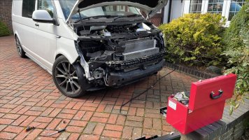

Hello mate, Yes I followed the bumper removal guide
Swapped the DLR ballast from headlight unit (There are two, one is for headlight and the other is DLR) with the Drivers side DLR ballast to confirm bad passenger side DLR ballast first.
This was the part I needed to replace the faulty DLR ballast (4G0.907.697.G Delphi 28548011 DLR light module).
check the label for your ballast to confirm that same or not).
Ordered replacement DLR module ballast from https://www.hids-direct.co.uk/
Installed new ballast and it worked!
Reinstalled bumper. Happy days. No ECU reset or anything like that needed (for me anyway).

View attachment 229482View attachment 229483
