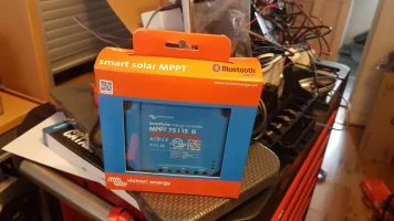

I've started this myself, i have the leisure batteries and a new Victron MPPT 75/115 controller, . . . . now just waiting for the Renology 100W solar suitcase (mobile unit) to arrive to start testing. (ill swap out the cheap PWM controller for the better Victron one)

This is the start of my setup . . . . . few more bits to go =]
im gonna swap out the RENOLOGY PWM charge controller for this Victron unit. (PWM comes are part of the 100W suitcase kit)
