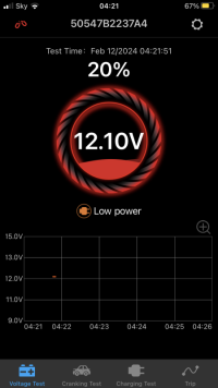

Leisure battery draining
so, thoughts?

What happened on Feb 8th?
As that's when you started to have a massive draw on the battery, which sent it spiralling into death.
Nothing?!
Spent a night in van night before 40odd miles away, used the fridge etc.
Then parked up.
Thoughts?!
Yes - looks like you drove the van a couple of times on the 8th - mid-day and later, but a load was switched on maybe an hour before the first drive and this has not been turned off and flattened the battery over the next 3 days
Genius!
Went back and checked everything. And I now understand just why folk replace the little rocker switch hillside use for pop top lights!
That little bugger was on!

A) have I screwed the battery permanently?

Yes - you’ve screwed the battery permanently
You have nothing to lose by taking the battery out and charging with a decent mains charger with an AGM profile and a reconditioning mode. That may recover it enough to make it useable for a while.
