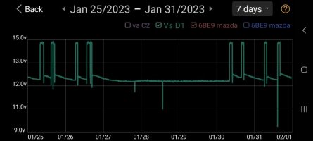

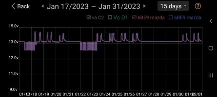

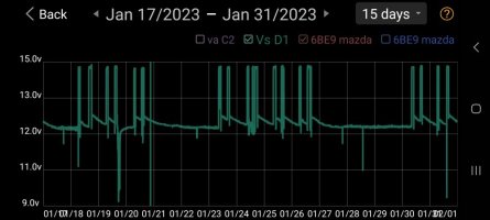

Post a few screen shots of the bm2 readout.
And a 7 and 15 day plot ..
Here's a 15 day plot for my leisure battery.

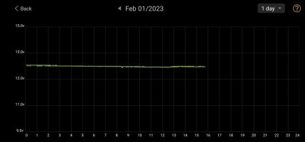

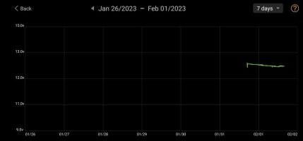

I've only put the bm2 device on since yesterday(it went from 99% to 76% then back up to 80% when i removed the fuses) so at the minute this is all i can give you.. I'll make a note to monitor over the next fortnight. Thanks.

That's looking ok to me.
I think you need to let it run for longer and see what happens over a 2 or 3 week period.
as long as the battery stays above 12.0 volts you're good.
Also your plot does not show any charging sources.
It's just showing a very slight static drain.
