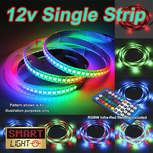

If you're willing to change a bit more you could get RGBW 12v LED strip and only connect the white and red lines (to ground through a 3 way SPDT ON-OFF-ON switch) and the +12v but then you need to get 3 core wiring in.
Some folks have used a short section of strip in an existing fitting. If you want to look at that remember that a 12v strip you can only cut every 3 LED, but there is an added complication with RGBW as some strips use all in one LED modules (cut every 3) and some use alternating RGB and White LED modules (cut every 6)

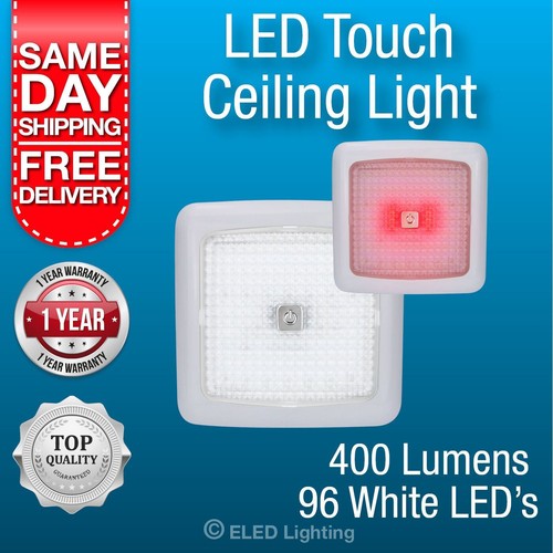

Nothing yet. The LED's that @roadtripper mentioned could work, but they are very expensive!
I also found these, and want to see if I can fit them
Is anyone aware whether they could be fitted?

They appear to be for a specific vehicle?
Not clear how they are switched between modes but the reviews seem to suggest it's a switch on the unit.
Also reviews mention the price is per unit, not per pair.
