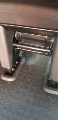

dandan88 Senior Member T6 Guru 10 Sep 2019 #1 guys Please help, Does my 2+1 seats fold over? I know the double does but does the single because I cannot get it to fold, hopefully I’m missing something? The single seat says underneath says easy entry seat. Can or does it fold forward Cheers guys

BognorMotors BMVS Sport & Performance Trade Member T6 Legend 10 Sep 2019 #2 Yes there is a little strap at the back to fold it

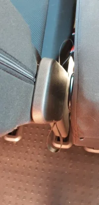

col661 Member T6 Pro 20 Sep 2019 #3 Its the strap here between the 1+2 rears.. you can pull from either way and the single will fold flat
col661 Member T6 Pro 20 Sep 2019 #4 This lever makes the seat fold forward for boot access and removal of seat. Operates when seat is either upright or flat.
col661 Member T6 Pro 20 Sep 2019 #5 Pull this handle up to remove single seat once flat.. might need a wiggle to free from mounts.
