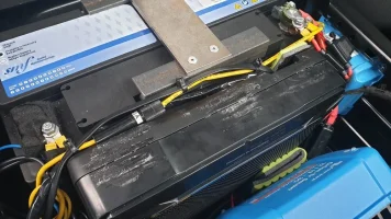

few pics maybe . . . im interested in your current setup and would like to know more.
make, model + pics of this - Voltron DC to DC charger
same here - Victron Solar charger
plus just general install . . pics show the install, gauge of cables, grounds etc etc ...

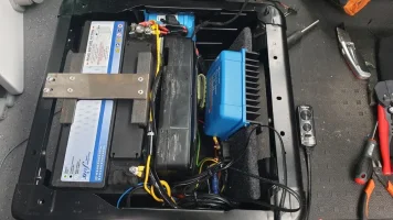

This is the DC-DC Charger charger though I am sure it was 400watt ?? It was £290 including the fitting kit - heavy gauge cables, connectors, fuses etc
As for pictures, its all under the drivers seat so unless I do go ahead and fit heated seat elements (chinese ebay kind) I won't be able to take more pictures

This is under the drivers seat. Took the pictures before it was completed to send to the previous owner of the vehicle - as I was sourcing advice.
I installed a Kenwood KSC-SW11 under seat sub woofer to go along with the a speaker and head unit upgrade as per your guide. It is temporarily wedged in place for testing in this photo with a cutting from an old yoga matt the wife bought and used once. The DC-DC charger is also not yet screwed in place. I installed so the heatsink is outwith the seat for better cooling.

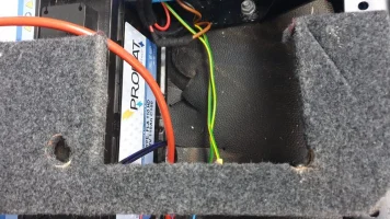

can you post a few pics of the starter battery NEG terminal ?
are there any cables or wires going direct to the NEG post of the starter battery? . . . bridging out the power sensor?
