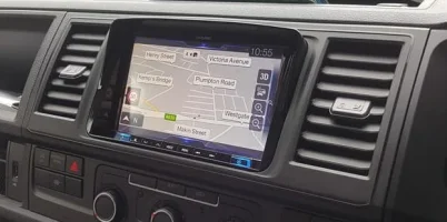

My pride and joy :)
Probably think I'm mad :rolleyes: but it was worth every penny to me :cool:
Thanks :)
I cant take credit for doing the work though, as its way way above my pay grade. That honour goes to R.A.M. Mobile. CD player in the cubbyhole has worked out even better than I hoped, easy to reach and makes use of an otherwise useless space to me. Just need to save up again for a sub now and its all sorted.
