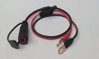

If you are direct on the battery, remember to not connect directly to the battery NEG post, use a separate chassis ground. Due to the power shunt on the battery.

Having seen how useful this is, I was planning to install a GC002 m6 eyelet terminal connector (pictured) and run that into the cab so I can just plug the noco in by the passenger footwell and not have any cables running from bonnet to passenger door.
If I fit this it sounds like I should fix the negative to a chassis ground near the battery then, right? Anyone recommend a known grounding point I should use close enough for this kit to be able to reach the battery positive comfortably?
