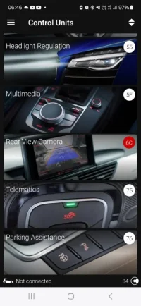

When I had my 72reg t6.1 I was able to fit and code the RVC, with OBDELEVEN pro.
I was speaking to someone who as both vcds and licence odis. He seems to think vcds is kind of had its day. A lot more software companies that are investing a lot in to R&D in the newer SFD protected modules. Obdeleven is one if them.
No SFD protection on these modules. I think it only applies on the mqb platform.
Have SFD on my 2023 caddy which I had to do a 2 step authentication process to read the modules.
RVC on the gateway. The red circle is because I didn't do a calibration with the domino board. But it workd perfectly.
