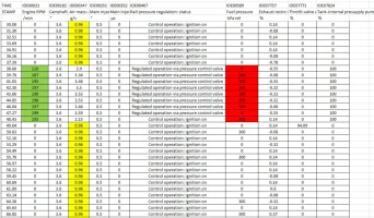

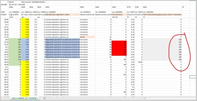

Fortunately, I'd expected this and had the VCDS cable and a laptop in the van so managed to capture a few logs as recommended in another thread, I'm hoping someone with more knowledge than me might be able to advise where to start trying to diagnose the problem.
The fuel pressure never builds up but I've no idea where else to look.

Apologies for the multiple logs, I tried it several times as I wasn't sure if I was capturing enough info in enough detail so tried multiple times. I've also attached a block map from last week when the van was starting.
