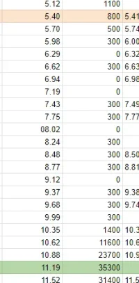

Hello, it has 1 year passed. Did you resolve your problem? I have almost same one. Only occour when night temperature fall below 5C degrees. I have replaced lifting pump in tank. and made plenty of measurments. Pressure 30 000kpa in rail is build after 4-5 sec of cranking. In rail the pressure stay at 0-300kpa level so no injectiors leaking. Only missing fuel in HPFP supply line. Only after cold night... All other situations car work smooth. Any new idea?

Faulty glow plug would not make fuel presure rise so slow. Find two sample of measurment below (left column - timestamp, right - railpressure in Kpa). Yellow marker starting crank, green - idle RPM (car start).
Seems like the rail pressure is ok when idling.
