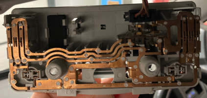

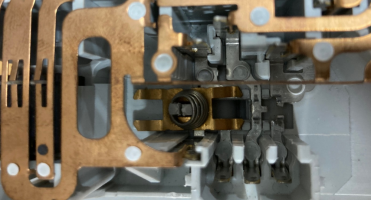

Try rattling the switch around when it is in the on when door open position. Mine got loose over the years and wore out. It might come on intermittently if you have a bad connection. You could buy a new one, or repair it like this if it is similar in design. You have to remove the light fitting (pop off the clear lens and undo a couple of T15s, then pull it out. There is a spring on mine which has lost its springiness and so the contacts aren't tight.
This is the back of the removed unit:
The spring is visible top right:
I added an M5 washer which sits between the top of the spring and the plastic barbs that form the rear of the sliding switch:
This tightens it all up nicely and never a problem since.
