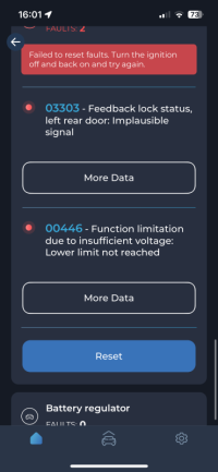

2017 T6 - Interior light wont work on door open / unlock, works normally on the on / off position. I read the faults with an OBD and have attached them but they have cleared with a flick of the reset button. Wondering if they’re linked or something else may be going on.
