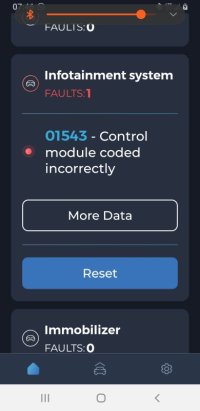

Infotainment system error??

Does keep reminding me the optical system isn't available on the screen...but I dont have cameras
That code is maybe suggesting your beep isn't working. Does your reversing 'beep beep your getting close to something' work?
I got the 01543 code after playing with Carista, I thought it would be good to change the start up picture on the display to GTi or one of the many choices, no, Carista says '01543'.
Change it back to the original screen and you won't get that error again! Nice while it lasted!
Ah! Thats something I've read about...but I dont think I've changed it at all.
Which is the original screen?
