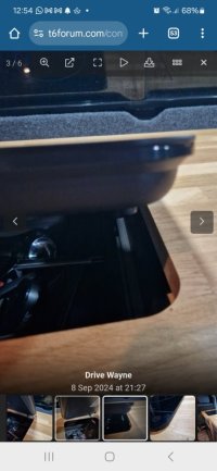

ht you said you had a built in one?Mine is a portable so we could take it out if required, they still make the same at the moment, so a replacement would be OK for the next week or so.
If it did pack up I would get the router out to make a hole for a bigger one.
It's a really useful coaster!
It fits in a routed hole, but still takeable outable, plugged into a socket under the worktop.I thiug

Thanks, how does it look when its sitting in place?
