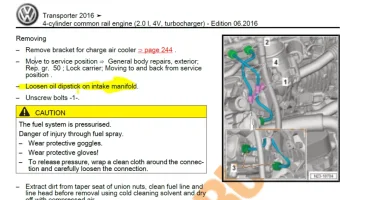

I'm in the process of changing the HPFP on a 2017 T6 with CXGB engine. I've followed a lot of the guidelines on the site along with the workshop manual instructions.
I'm now a bit stumped with a step to get access to pump union nuts where you need to move the oil dipstick tube. Access is fairly tight and I just can't figure out how to do what should be a very simple step? I've removed a bolt on the intake manifold that I thought may be holding it but it still wont budge.
Any tips?
Cheers!
I can't even remember removing the dipstick tube when I replaced my pump. Maybe I did, who knows
Try spraying some lube at the base of the tube and give it a good waggle about. They usually get stuck in the 'o' ring at the base. A good waggle and keep spraying stuff down at the base and it will eventually give up the fight and come out.
Thanks for the tips. It was a simple screw that I just couldn't see as it's hidden from view.
