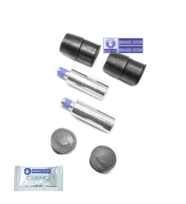

I don’t think I’ve ever come across a set of caliper guide pins that actually needed renewing, they are coated in grease, the VW ones are stainless steel.
While a caliper overhaul kit contains new guide pins there isn’t a requirement to renew them, they only contact rubber so no pin wear.

Mine have a ridge on them about half way along their length. Do you know if this is normal please?
Definitely not normal, were they dry when dis-assembled?
They were quite dry. Here's what they look like. IMG_4904.webpI've only dismantled one side so far. Pad wear seems even inboard to outboard.

Thanks, not a bad shout but not sure that would work in this case it's more of a scored groove than a ridge. I have new ones coming from autodoc soon so I'll swap them out. Wondering what the other side will be like when I get to that one!
I wouldn’t advise removing the ridge as mentioned, that just makes it an undersize pin which just isn’t right.
There are plenty of aftermarket caliper overhaul kits, if your calipers haven’t been overhauled for 10 years then they are probably due anyway. Not sure how old your van is.
The grease supplied in the caliper overhaul kits is never enough which maybe why the pins were dry when you removed them.
Thanks, it's a 19 plate, on 30k miles. The first owners only did 8k miles in the three years they owned it and it spent quite a while sitting unused in their driveway so I suspect it's from back then. We do about 6k miles a year now and I try to do a journey at least once a week in it.
If it were mine and a keeper I’d overhaul the calipers while they are off, if you do the same mileage over the next 7 years it’s unlikely you get to the next pad change problem free.
