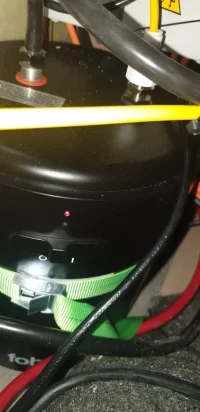

Re the corrosive aspect - is this likely to damage the boiler I have for my Quooker tap (see below)?

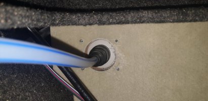

This is the filler point in the back of the van...

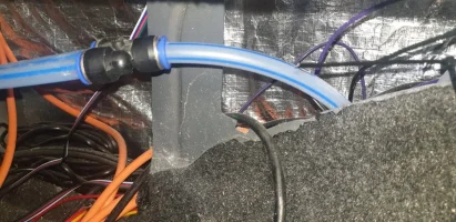

Chasing the pipe back through the van, it would appear the water tank is sited behind the fridge (which seems an odd location!?), so can't get a pic of that.
Here's a pic of the boiler...

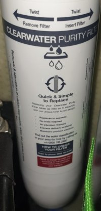

...and then I found this bad boy tucked away by the side of the boiler...
This might be a stupid question (my speciality), but does this do the same job as the steriliser products or is this something specifically for the boiler?
that looks good.
i have no idea, but assuming that is a particulate filter for water purity.
and not a biocide, for pipework and tank cleaner.
