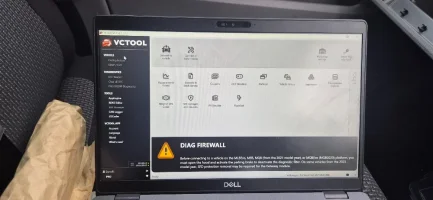

Try vctool software.
A chap from America put me on to this.
I am very green when it comes to computers and coding, but slowly learning and can say this software is pretty powerful.
You can get free accounts to full fat yearly subscriptions for a few hundreds euros, or monthly subs.
You will get access to other t6.1 vans that have been uploaded to the sites servers and also download factory datasets for any module or request them to the admin team.
I am sure you could get the correct datasets for the webasto heater. Either by searching other t6.1 vans on the list or by requesting it.
Plus, it is cheaper than genuine odis e which is dealership level invite only I believe.
Will use it to code my factory led headlights to my t6.1
It was also able to code the factory led headlights to my previous caddy5 with sfd protection on bcm.
I'll have a look tonight amongst the vans to see if any on there have this heater fitted.

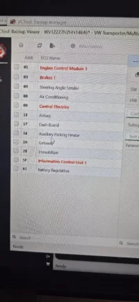

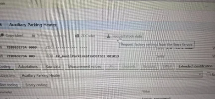

Andy, have managed to find a T6 on vctools with auxiliary heater.
Part number is pointing to webasto.
If you are good with computers, it may pay to subscribe to the system and request the stock datasets from this module.
There is also a couple of 2018 models on the back up server.
@DanW81 that is really useful thanks pal! I’m gonna hit the order tonight as it also looks like the most cost effective solution and I had a good play around on the free software last night. I can order just the ECU flasher module rather than a subscription for €78 which should give me exactly what I need.! Awesome!
