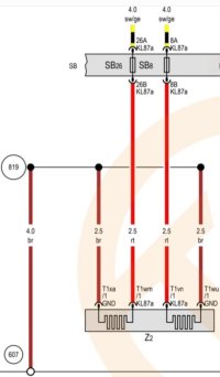

Well that's just typical! The 3 year warranty on my T6.1 ran out a couple of weeks ago, I fired up my van this morning in a heavy frost to find a 1 foot section of the heated screen has failed, on top of the other 2 single wires that had failed a while back.
Before I pull anything apart, or just ignore it, does anyone know why a big section has suddenly failed? I can see how individual wires could fail, but there must be around 30 in a row failed. How are the screens wired? Is it multiple 12V and ground connections, or just one 12V and ground, and all connections are internal to the glass? Obviously if the latter, there is bugger all I can do apart from replace the whole screen, but it would be great if there was something external that could be repaired!
Unfortunately not much to be repaired externally.
Have a look in the downloads section.

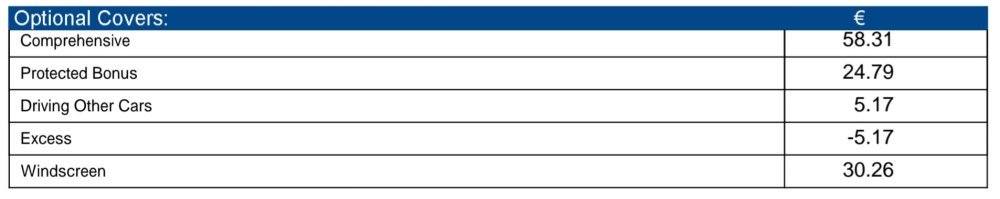

Have you got windscreen cover from your insurer?
I pay €30.26 extra every year and my insurer pays for my windscreen replacement.

Thanks for the diagram! Looks like I'm just going to have to live with it until such a point that the screen gets broken, if that even happens.
Strictly speaking your windscreen is broken if the heating element is shot?

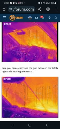

The screen is split into two heater sections as above.
With a very thin line separating them in the middle.
Have you got any pics...
If it was a fuse or other you would loose one half or both.
