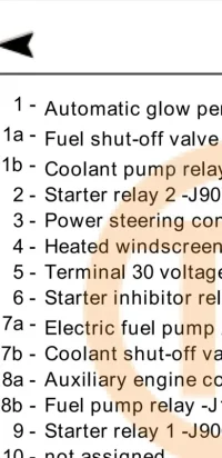

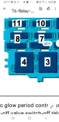

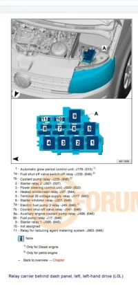

It's all in the download section.
Screenshot_20191121-221716_Drive.webp Screenshot_20191121-221708_Drive.webp Screenshot_20191121-221657_Drive.webp
Under(remove) the battery, remove cover(don't drop the screws)
