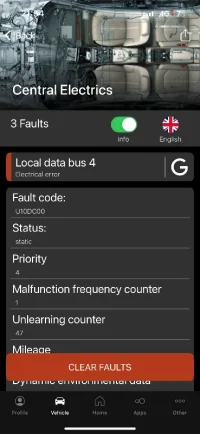

Currently having an issue with my T6.1 where the auto headlights, rain sensor and heated seats have all stopped working together.
The only fault I get though OBDEleven is local data bus 4, data message missing.
I’ve booked it into a local garage. They seem to think it is the heated seat module that has failed (though they can’t confirm this without stripping the seats down to get to the module. I’m concerned this might not be the issue as I can’t see how the 3 systems are linked in the wiring diagrams?

The van is with them currently, so can’t get a current scan. I have scanned it with ODBEleven and just got the local data bus 4 missing message in the central electrics module. No other codes. The code is permanently latched as well and will not reset. Tried a bit of digging with ODBEleven but couldn’t get any more data on the fault unfortunately, hence I booked it in (mainly due to lack of time to look at it). When headlights are set to Auto it shows a fault on the MFD ‘Fault: Automatic Headlight Control’
G213 rain sensor and J774 heated front seats control unit are members of LIN 4 bus (local data bus) - communicating with the BCM - central electrics.
As the G213 is actually combined rain/light sensor I would expect that fixing the bus issue would solve all the issues at once.
Unfortunately the bus is incorrectly labeled as LIN 2 in below page 51/6 (corrected to LIN 4 in later revisions)

Thanks really appreciate it. - makes a lot of sense now. Any advice on the best way to diagnose the root cause of the fault with the LIN bus? Is it a physical module or just a connection node under the seat?
The bus itself is just a single wire (purple/green) from BCM (T73c/15) which splits (somewhere) into all units on the bus - of course the wire then is part of wiring loom.
I don't think it's under a seat - seems to be straight (without intermediate connectors) connection from BCM to the G213 and J774, as well as the anti-theft alarm sensors G578 (if equipped).
The rain sensor and anti-theft alarm sensor are in rear view mirror base - check the voltage on the bus (about 12V). Also could disconnect one connector at a time to see if it makes a difference (a unit shorting the bus?).

I’ve started having a look at this again today.
Initially checked fuses individually as suggested - no joy. The fault remains the same.
Scanned it again and the two faults are the same (see pictures below). Will continue investigation tomorrow.

Thanks for your help with this folks - not been able to look at it for a while due to work. Finally found some damaged wires in the interior monitor module. Had some black tape round it, so clearly been out in the past for a repair. IMG_4014.webp
