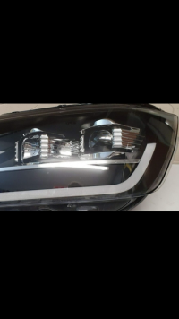

Those are THQ V3 lights and are a direct replacement for either H4 or H7 lights. Vans that originally had H4 headlights require coding so that dipped beam remains on with main beam though.
Replaced my standard H4 headlights on my 17 plate kombi highline with genuine H7 headlights from a 17 plate Caravelle. It's literally just plug and play, no warning lights, no VCDS, just swap and go. Does require removing the front bumper but really not as bad as it sounds. IMO the H7's are...

@teamfly got some aftermarket H7s from Europarts, of course you would have to but the bulbs separately:
I have a pair of H7's waiting to go in when I have time to fit them. Probably a silly question but what happens with the headlight level adjuster? I assume that when I adjust the level in the cab it moves something in the lights, how do I know the old and new lights were set to same level...
