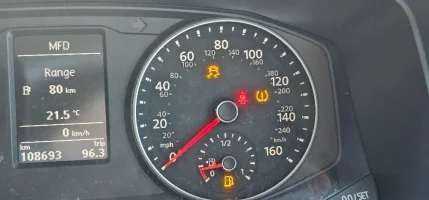

I have a 2017 T32 auto that's giving me some electrical issues and wondering if any of you have had similar?
As per the attached photos I have warnings for front assist not working. Start stop not working, ABS light has come on and strangely tyre pressure sensor not found (even though it's never had internal sensors. Just the ABS system). Now if the ABS system isn't working I get the tyre sensor issue however all these things at once must be connected.

Far more knowledgable people on here than myself on here but what amazes me is one small fault can cause issues in many things in modern machinery. Wheel sensor problems can cause some of the things that you report but I guess having the codes read and displayed on here is going to help those more able to help you.
Not sure about the start stop issues, could be one of many things but the other problems are almost certainly caused by a broken wheel speed sensor. Scanning your van with VCDS or similar will identify which one.
As above, get a scan done. You may not even need full VCDS kit to show a likely culprit.

It's a common fault and as wheel speed is used in the calculations for many electronic systems, a simple sensor failure can cause a number of systems to fail.
I'm confident that front assist will need to know the vehicle speed too so my money's on a wheel speed sensor.
Bear in mind that your ABS cannot function properly without all the information that it needs.
