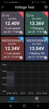

heres a view from the van showing the starter battery and Leisure battery . . . via the Renogy DC50 charger.

If you have two (or more) BM-2 battery monitors . . .
You can use the BM3 APP that allows you to see three Four BM-2 units simultaneously . .

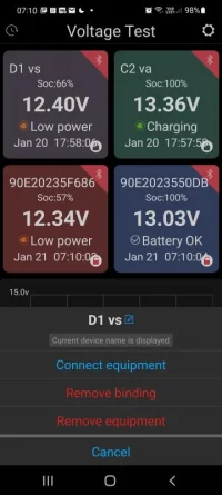

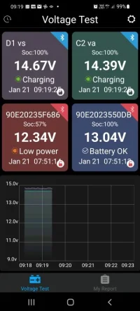

Upto 4x BM2 device simultaneously... (I have around 8x BM2. it will jump to the first ones it's sees... But you can lock a BM2 to a square / position.... So I always have VS and VA at the top... That's van starter/aux batteries..... The other two boxes I jump to whatever BM2 I want..... IE car . Solar etc)
If you install it you need to uninstall the standard version.... Or they clash. And either version will lock onto a BM2, and block the other version.
Though you can get around that by going into the phones settings and switching background use (power,data,memory. Everything) for both apps.... making sure that the app is fully dead. Then you can successfully switch between app...
Or just uninstall. And use one or other.
Same as other app. 1,7,15 day view plus calendar.
And you can enable/disable any BMW in any views
