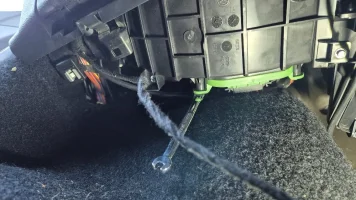

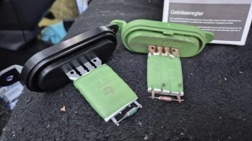

I've just done my fan blower resistor pack for the second time on the 2018 van.
A git of a job due to the limited space and carpet in the cab... But definitely a diy job with some patients.

Thanks for these pictures. I was just wondering, do you run your heater fan mostly on the slowest speed? I have been and assume that's the one that would create most heat build up through the resistor unit. Obviously crap design on how many seem to fail and surprised it hasn't been engineered out by now (when buying a replacement unit). Bit like the old dim/dip running headlights manufactures used to use. One would have thought they would have learnt the lesson then, wouldn't one! :)
Yes I 99.5% of the time just leave it on #1.
And yes that burns off most heat in the resistor pack.
The thermal fuse is a safety feature and id consider the unit a serviceable part, once every 3 years in my case.... And I'm fine with that.
There was a period a while ago where some Vauxhalls were catching aligh and burning to the ground because of a faulty fan blower pack !!!.... So that fuse is a very important part.
Replaced it today....... I'm 67 - didn't know my body could still bend in places like that! 🤣
