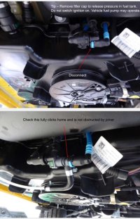

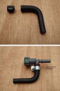

This is the only thing that was connected to the fuel tank... a quick connection... just wondering if the noise is more prominent due to the fact that I have cut 2 holes in the floor for the vent pipes to enter the vehicle

The second pictures text states "do not switch on ignition. vehicle pump may operate" this infers that the tee is placed in the pressurized line which is incorrect - see the Webasto installation manual.
Someone is giving you duff information.
Those tees are available everywhere no need to pay over the odds from Butler Technic as they are only around £3.
