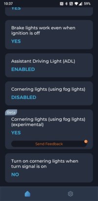

My front foglights wont come on from the headlight switch. The fogs are working cos I've got them to come on on coming home lights setting via carista. Anyone any ideas?.
Did it coincide with setting via Carista? Have you tried reverting back to previous set-up?
Please post "Detailed ECU info"-report (under Carista Service menu).
No i set the coming home lights with carista about 3 years ago. My mates borrowed my carista and i wont see him for a week so i cant do anything with it til he gets back off holiday. Just seems weird them not coming on since it come back from a service at vw?.

Not really answering your question, but I used to have a B7 Passat. Not sure if you are familiar with them, but they have the DRL in the lamp next to the fog light. I coded my foglights as DRLs and reduced the brightness to match the original DRLs next to them.
Now what this did was stopped the fogs as cornering light function. This was because the BCM was telling the fog lights (now DRLs) to turn off when the headlights are on. Corning lights work with dipped headlights, so no juice was getting to them.
It could be a similar thing with yours. Something is coded that has inadvertently switched off another function.
