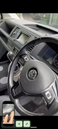

i could do with a pic of your wheel tbh
but does it look similar to this ?
im pretty sure it will fit yes
i have fitted the vw passat b8 ones without any issues
side by side comparison is the best way to be sure

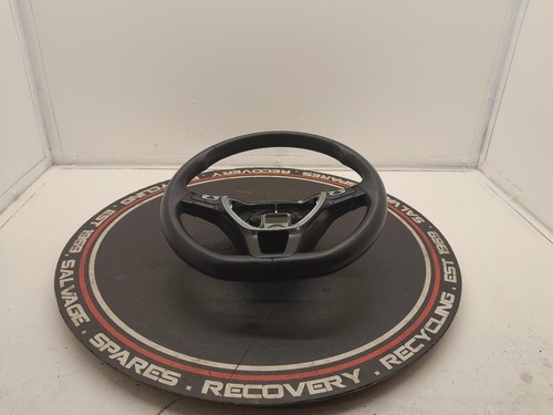

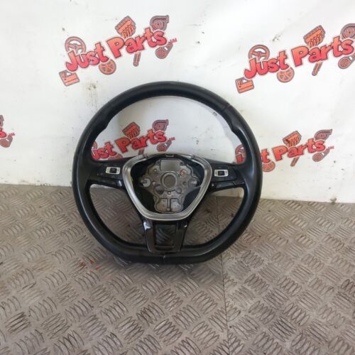

Hi all, I've just purchased this for £60.00 delivered
Is it okay?
No, wrong air bag connectors. You need the two metal hooks at 9 and 3 o'clock rather than the three round 'bits'.
Argh.. thought it was a bargain, thank you. I see what you mean now
