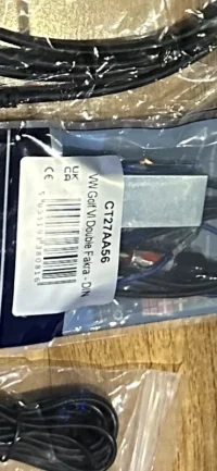

And I’m not sure if I’ve got the correct adapter for what I presume is the FM Ariel. It’s got the double green plug at one end which I tried to plug into a similar double socket removed from the original head unit but they don’t go together. Maybe wrong adapter? It says golf on the packet. Also what’s the blue wire for? that’s attached to this same adapter and where does it go?

when you removed the fM plug away from the old Vw radio you didn’t remove it correctly resulting in pulling part of it from the radio now it’s stuck in the plug it self.. remove this then the new adapter will fit correctly
the blue lead goes to the blue lead on the pioneer

I’ve removed the bit from the FM plug and it fits great now thanks.
Still not sure where the blue cable goes. It has a weird metal end on it. There doesn’t appear to be a blue cable coming from the pioneer.
I’ve attached pics of the cables.
Cheers
The terminal is a iso pin designed to slot into the iso plug, line it up with the blue white system remote wire, or cut it of and attempt h to the system remote
