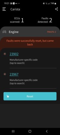

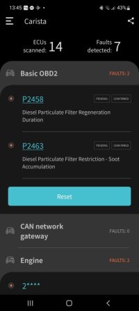

Got 2 fault codes from carista P5824 DPF Regeneration Duration and P2463 DPF restricted soot accumulation. Engine fault 23902 and 23967 both say manufacturer specific code. Got the coil light flashing Amber and engine light on steady Amber light. On carista it came up with soot level 59 99% and press here for a regen which I have done 3 times now and nothing has happened (revs 2000/2500 for 20mins each time )
Van runs OK with no signs of smoke out of exhaust, no loss of power, no knocking noise from engine, no uneven revs on idle. Do you think a terraclean will clear the faults Thanks Sam
