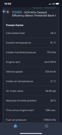

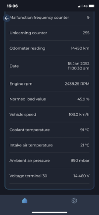

Hi So on our way on holiday for a week to Devon , had the the emissions light come on and with Carista the above codes . Will a software update sort this ? Please see attached Carista download from service menu and photos of expanded fault codes .Have I got the latest software? It’s a 2019 T6 102 5 speed manual 9000 miles only .

Further on had adblu fault distance to refill dropped to 650 miles , reset itself after about 20 miles had the following fault codes when I scanned basic obd2 codes P0401, P204F , P20EE and engine codes 23871 , 31103 ,33262 , could these still be software related or do I have a bigger issue ?

23871 = P0401 EGR System Insufficient Flow
31103 = P20EE SCR NOx Catalyst Bank 1 Efficiency too Low
33262 = P204F Reductant System Performance Bank 1 Malfunction
The first ones are VW codes, P-codes are OBD-II-standard equivalents.
The AdBlue display distance 650 miles was triggered by P204F. The software update should cure false alarms of the fault.
P20EE itself is more or less harmless - just an indication NOx emissions were above threshold. The software update reduces NOx emissions and thus also reduces P20EE faults.

For code 31103 check out the below thread - apparently nothing too bad. Please post contents of ”Detailed ECU info" -report (under CaristaService menu)” - there has been an engine software update that should make these faults less frequent.
@n10n here is the detailed ECU info: (I copied it and forgot to take a screenshot of how it was split up on the screen. Hope it is readable!)
ECU info obtained with Carista 8.2.2 for iOS: VIN: WV1ZZZ7HZKH041064 CAN network gateway Part #: 7E0909901 Component: GW-K-CAN TP20 Software version: 0762 ASAM/ODX identifier: [none] Coding: 042305 (hex) [No fault codes] Engine Part #: 04L906056KA Component: R4 2.0l TDI Software version: 4047 ASAM/ODX identifier: EV_ECM20TDI03004L906056KA Coding: 00114010432401090000 (hex) Fault codes: 15916 Manufacturer-specific code 31103 Manufacturer-specific code ABS Part #: 7E0907379P Component: ESC Software version: 0133 ASAM/ODX identifier: EV_Brake1ESCCONTIVN75XGP2 Coding: 557E40982566847FAA75027CA48621E679F100 (hex) [No fault codes] Steering angle Part #: 6R0959654 Component: LENKW.SENSOR Software version: 0070 ASAM/ODX identifier: EV_LWSKLOVW25X Coding: 01 (hex) [No fault codes] Airbags Part #: 7E0959655J Component: VW10Airbag021 Software version: 0018 ASAM/ODX identifier: EV_AirbaVW10BPAVW12X Coding: 000000000000000000000000000000003231 (hex) [No fault codes] Instrument cluster Part #: 7E0920971A Component: KOMBI Software version: 2030 ASAM/ODX identifier: EV_Kombi_UDS_VDD_RM09 Coding: 450B010300 (hex) [No fault codes] Infotainment system Part #: 1K8035150L Component: MU-E-D-ER Software version: 7205 ASAM/ODX identifier: EV_MUEnt4CGen2LGE Coding: 065700003C00000041111101008000001F0000C60000010001 (hex) [No fault codes] Immobilizer Part #: 5K0953234 Component: IMMO Software version: 2030 ASAM/ODX identifier: EV_Immo_UDS_VDD_RM09 Coding: 000002 (hex) [No fault codes] Parking/steering assist Part #: 7E0919475T Component: PARKHILFE 4K Software version: 0212 ASAM/ODX identifier: EV_VW75XParkAssis4K Coding: 10800A (hex) [No fault codes] Central electronics Part #: 7E0937090D Component: BCM PQ25 Max4 Software version: 0762 ASAM/ODX identifier: [none] Coding: E0A4303A0A212031002009742C2B8C500F80708F60444D60330400220800 (hex) Fault codes: 03442 Manufacturer-specific code Battery regulator Part #: 7E0907534 Component: Batt.regelung Software version: 0762 ASAM/ODX identifier: [none] Coding: 030B7A73 (hex) [No fault codes] Adaptive cruise control Part #: 7N0907572C Component: ACC Bosch PQx Software version: 0211 ASAM/ODX identifier: EV_ACCBEGVW361 Coding: 00004000FE0779 (hex) Fault codes: 01132 Manufacturer-specific code 01542 Manufacturer-specific code 01545 Manufacturer-specific code Obtained with Carista 8.2.2 for iOS.
