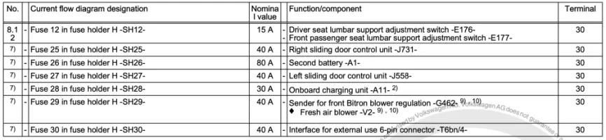

The wiring diagram for the factory non camper battery is here if you have VIP membership

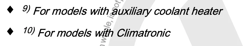

The only other thing I can see using a 40amp fuse from the factory in that fusebox that has not been mentioned is the "interface for external use" - is the van an ex fleet van that might have had additional equipment in?
Webasto? I remembered rear blower but was really front one when factory webasto installed. Or the external use interface if such is fitted.
No. It's a 17 plate DSG panel van.
