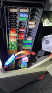

I am putting a usb socket into the top dash blanked-off hole.
There is no existing wiring.
So I've run 12v cable down to the fuse box to the left of the gear knob.
I want this socket to be ignition-on only.
So my understanding is that the top middle row of fuses is ignition live. Numbers 37, 36, 34, 33, 32.
I have read posts on here where a piggyback has been inserted into 35.
My 35 is occupied by a 30a fuse - I think it's for the tow bar electrics.
Would I be ok to put the piggyback into the unoccupied 34?
Or will the world end?
I know @Dellmassive has detailed knowledge here and would appreciate a thought.
I have attached a pic of my fuse box. Filth, I know.
Thanks in advance,
LB
Yes you can use an unoccupied slot.
