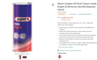

looks like the Wynns stuff is still available !!!
Once I read that it cleans hydraulic systems the BS is smelling strong, the only way to clean hydraulic systems is with a flush with hot, agitated and turbulent hydraulic oil.
If some snake oil did the job it would save hundreds of thousands in industrial systems.
As for engines; centrifuges and heaters do what a filter cannot do.
