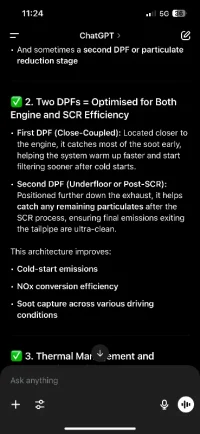

now i'm confused as when i google "does a t6 have dual dpf" all i get is no it doesn't have a dual dpf?
AI bot searches just summarise info from various sources. It tries to relieve the human from sifting through search engine results. If you want accuracy you’re better off doing it ‘old school’ (which sounds ridiculous as it feels like yesterday I was in school and the internet as we know it wasn’t around - I had to visit a public library to get info for homework) and actually looking at the results yourself as you can quickly sort the wheat from the chaff.
AI also lies and lies again to cover its tracks. No joke. Plenty of cases of this happening. Basically I would say it’s current use is beta testing but people aren’t told this so assume it’s accurate.

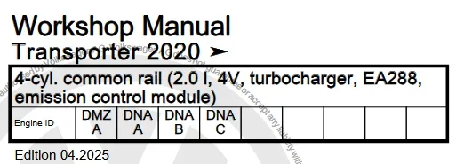

I went under the vehicle in the garage it has two
That is some serious fact checking. Fair play. 💪
I stand by my opinion AI isn’t as good as it should be though and is open to serious abuse. The articles of it telling porkies to cover mistakes are concerning because not everyone checks things out for themselves.
Apologies if my original post was taken as a dig at you - it wasn’t meant to be.
So two DPFs and a cat. Plus EGR. Lordy.
