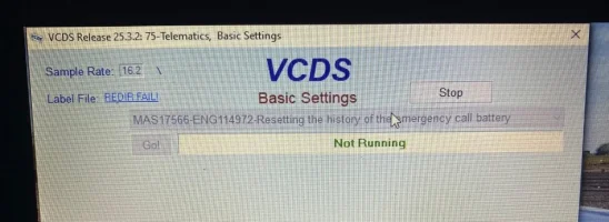

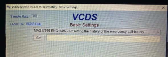

Goto: Module 75 Telematics -> Basic Settings -> Resetting the history of the emergency call battery
Press Go
You will see the message 'Not Running'; this is not an error, the task completes in mS and this would ideally say 'Completed'
