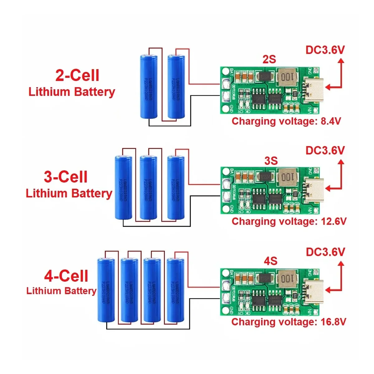

Hi, I made a 7v usb charger, cut the connector off and added crocodile clips to the ends so I could push pins in to the battery plug
It took a few hours to charge it but worked,
It is useful to add that the eCall battery contains two LiPo cells in series.
The nominal voltage on a LiPo cell is 3.7v, rising to 4.2v fully charged.
A power source of 8v will provide a faster charge and the eCall battery will register 90% plus when you reset the eCall battery history.
Maybe post where you got the charger from? Also if there is an 8V version, just in case others want to do this fix? 👍
