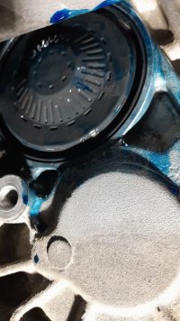

Lever the seal out, lubricate the new seal lip , fit it in position and then with a piece of wood you can work the seal into position and tap it in.

The seal fails as its a metal cap and the metal is exposed in the grooves in the cap hence the rust on the cap. The new version doesn't have any exposed metal, i took no chances and overcoated it.
