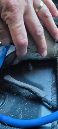

Hello everyone. In the process of fitting a consumer unit and cables under driver seat.
Can I use the nut and bolt under the rubber matting under the seat as in the pic?
Thanks.
yep thats a factory earth stud and one of the few that doesnt normally have any wires attached to it

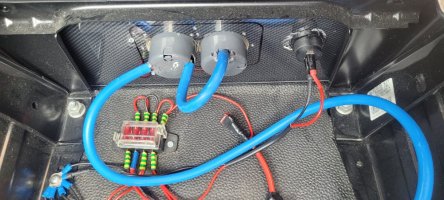

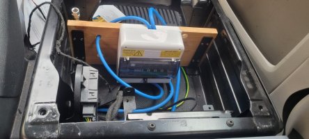

Thanks for the replies. Very grateful. Here are some pics of the installation to date.
Not professional by any standards, but happy with what I've done.
Thanks again everyone.
Anything wrong with using boot lace ferrules like I've done to get a more secure connection in the consumer unit and then the plugs?

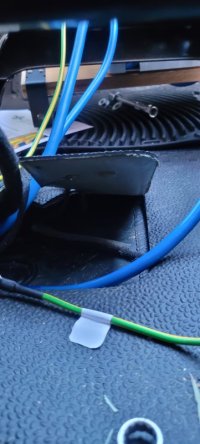

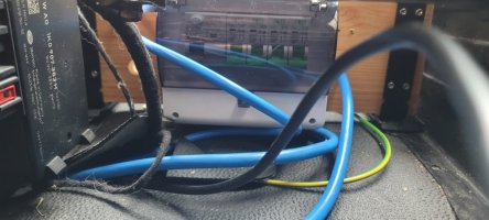

Only me again. Can I have any thoughts on the wiring that has been all connected but loose under the passenger seat? Does it need to be tidied up further?
