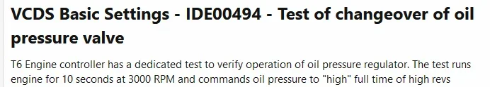

Have you read the link from MMI above in relation to the oil pressure changeover valve?
I had the coil light and the oil pressure switch fault. Changed both oil pressure switches and fault still remained.
The changeover valve failed the VCDS test and after having that replaced I've had no problems.
Valve swap cost £220 at local indy.
