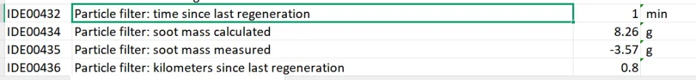

I have the ios version of dpf monitor for vag. i just open the app on the radio screen even if the app is not running on my phone and seems to work really well. regens at 100% and 30g soot which i believe is set by engine spec at setup and can be manually adjusted, Keeps a history as well
I monitored live soot levels yesterday whilst on a motorway drive. Soot got up to around 30g before commencing a regen which took approximately 17 minutes to complete and then dropped down to around 8g. Handy to know that when the soot levels are approaching 30g I need to take the van for a 20 minute drive for a successful regen.
