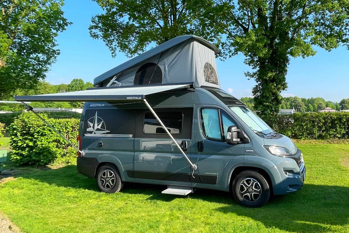

Have a look at the Westfalia conversions on VW (Joker?) and Ford (Nugget) for ideas.
Rear elevating roof, toilet and shower at the back, rear side kitchen.

Yes, Westfalia's might be worth a look thanks.
