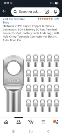

I used the splice block to tap into the factory red live. I then ran the live through the Anl fuse into my dc to dc charger. I used 10 awg silicone tinned copper wire. Works beautifuly. The Anl fuse holder comes with a 30amp fuse. All sourced from amazon.
