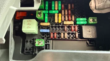

Yes you’re right, saw the thread where @Deaky posted a description and a pic, but for the life of me I can’t get it to function. Thanks man, that would be appreciatedCan't remember off the top of my head but I think the middle row of fuses are ig live. I'll take a pic of mine tomorrow if I think on

@Deaky this is the photo I was going by.
And you've definitely got two fuses in each piggy back. One from the existing circuit and one for the dashcam?@Deaky this is the photo I was going by.
First I tried the 10A - piggy back into 2nd bay in from the right, put the 10A into the piggy, wire pointing up, then the ground to the body behind the dash, turned key and nothing.
Repeated using a spare slot, 2nd baby from left, 10A fuse left into the piggy at the wire side and the other left empty, ground to the body behind dash, turned key, again nothing.
I’m no electrician by any means but I just can’t suss what’s wrong, previous T6 was plug and play I stand and it’s the same camera being used.
Yes I did when replacing a fuse, but when using empty port I left the one on the piggy empty, the fuse in the one in line with the wire. It’s a nextbase 312GWAnd you've definitely got two fuses in each piggy back. One from the existing circuit and one for the dashcam?
