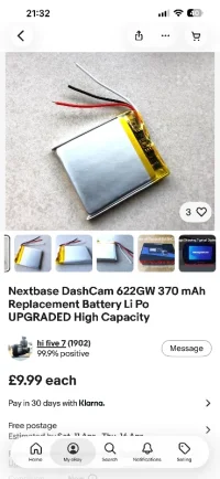

There I swapped the battery in the Dash cam and it's fine now!
I’m having that issue, what type battery did you change too?
